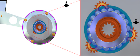

Zoom views in or out
Use Zoom to zoom the view in the graphics window in or out to achieve the desired scale. You can zoom the view while other commands are active.
- On Navigation bar
Zoom.
- Use the arrow cursor to click and drag the view to the desired scale. Dragging up or down changes the view in accordance with the
 Options Mouse Options setting for Mouse Zoom Options.
