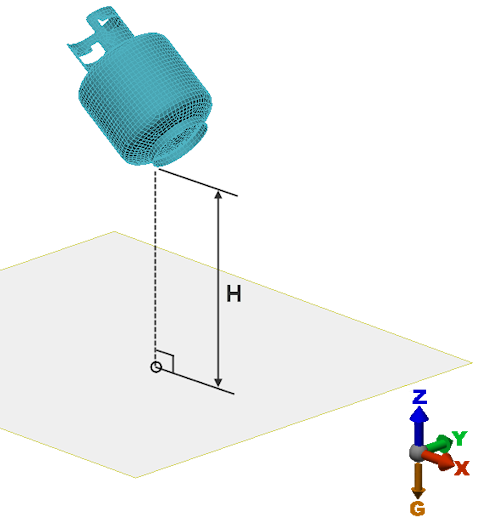

Step 2: Drop Height, Gravity, and Impact Plane Options
On the second dialog box of the wizard, you specify the following items:
- Height form which your model will be dropped. There are two options... - Drop Height H measured from lowest point. For this option, an impact plane will be created at the specified distance below the lowest point on the model (with the direction consistent with the gravity direction).
- Drop Height H measured from selected point. For this option, you can either enter the X, Y, and Z coordinates in the provided input fields, or select a vertex on the model and click the Select button.
- Gravity (g). The standard gravitational acceleration constant will be pre-defined in the current display units. You can also change the value to simulate higher or lower acceleration rates.
- Set direction of gravity. Use this drop-down list to choose any of the six global directions: +/-X, +/-Y, or +/-Z.
- Create Impact Plane. If an impact plane has been created previously by the Drop Test Wizard, this button will instead be labeled Modify Impact Plane. Click this button to either create the impact plane or to update the definition of a previously created impact plane.
- Fully general. This is the default type of impact plane for a drop test. The model can bounce off of the plane after impact or slide along it. If you wish to prevent bouncing and allow only sliding contact, click this button and choose the alternative Slide / no bounce option from the drop-down list. Once a point or surface of the model contacts the impact plane, it will not separate from it when the Slide / no bounce option is specified.
- Create/modify impact plane when Next button is clicked. When this checkbox is activated, you do not have to separately click the Create Impact Plane or Modify Impact Plane button. The action will occur automatically when you click the Next button to advance to step 3. This option is activated by default.
Figure 1: Drop Test Example (Gravity in -Z Direction, H Based on Lowest Point on Model)
