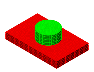

By adding the support to the CAD solid model and importing into Autodesk Simulation, the circular pattern desired for the boundary conditions is created by the mesh matching. |

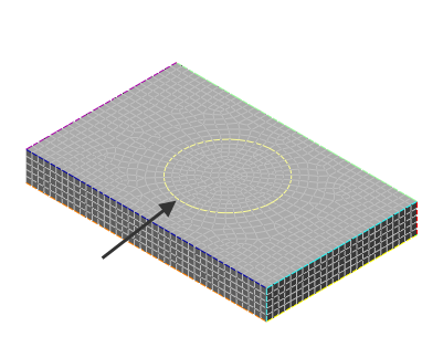

Furthermore, by using the surface splitting during the import, the rectangular face is split into a surface of a rectangle with a hole and a surface of a circle. This also adds new edges to the model (the perimeter of the support in yellow, arrowed) making it very easy to apply the boundary conditions to the edge of the surface. If a pressure were being applied instead of boundary conditions, the circular area can be selected with using the splitting. Since the support is not required in the analysis, it can be deactivated in the FEA Editor. |
