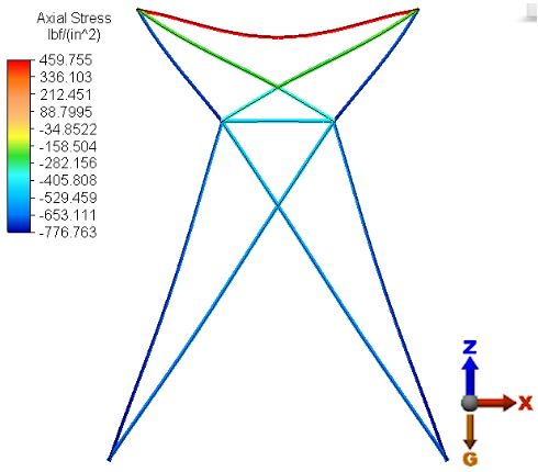

We will now review the axial and bending stresses in the beams.
  1. Select Results Contours Stress Beam and Truss Axial Stress. The maximum tensile value is 460 psi. The maximum compressive value is -777 psi.
