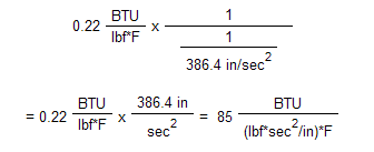

Another example of the proper conversion to mass units is the specific heat. The specific heat of Aluminum 2024 is 0.22 BTU/(lbm*F). The conversion procedure to mass units when using Model Units is as follows:
0.22 BTU/(lbm*F) = 0.22 BTU/(lbf*F)
To convert to consistent mass units, divide the weight by gravity. Since the weight term is in the denominator, dividing weight by gravity results in the gravity term in the numerator:
where again the term lbf*sec 2 /in represents the mass. 85 is entered as the specific heat in the material properties. You should be able to confirm, dimensionally at least, that specific heat times mass will result in the correct value:
