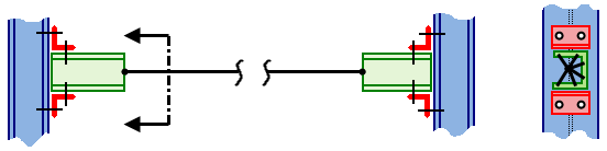

Connect Lines to the Centroid
 Centroid Creator: The general purpose of this command is to calculate the centroid location of a surface (composed of one or more surface numbers), and optionally connect the nodes on the selected surface to the centroid with line elements. When used on two separate surfaces, the two centroids can be connected with a line element.
For example, consider a long channel used in a structure, and the interaction of the bolted connections at each end are to be studied in detail. So a CAD model of the beam, bolts, and connection is created. If the span of the channel is not of interest in the analysis, it can be replaced with a few beam elements to greatly reduce the size of the analysis. The Centroid Calculator automates the process of connecting each node on the cut end of the channel to the centroid, and then connecting the two centroids. See the following figure.
(a) Full CAD model in which the entire horizontal channel is modeled with brick elements.
(b) More efficient model in which a portion of the horizontal channel is modeled with beam elements. Only the portion requiring the detail provided by brick elements is modeled in the CAD.
