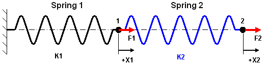

In one form or another, Finite Element Analysis (FEA) comes down to solving a set of equations. Take the simple two spring model shown below, where F1 and F2 are the applied loads, K1 and K2 are the stiffness of the springs, and X1 and X2 are the deflections of each end. Keep in mind that either of the applied loads can be zero, but each one is a known value. The force developed in each spring due to elongation is unknown, but it can be calculated from the direct formula F = k*x. Considering that spring 1 elongates by the amount X1 and spring 2 elongates by the amount (X2-X1), we can write the equation for the sum of the forces at each node:
| F1 - K1*X1 + K2*(X2-X1) = 0 | node 1 |
| F2 - K2*(X2-X1) = 0 | node 2 |
Rearranging the equations gives:
| F1 = (K1 + K2)*X1 - K2*X2 | node 1 |
| F2 = -K2*X1 + K2*X2 | node 2 |
These equations can be expressed in matrix form as follows:
or in shorthand notation, {F} = [K]{X}.
