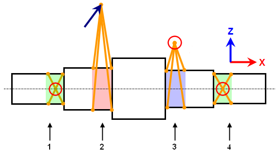

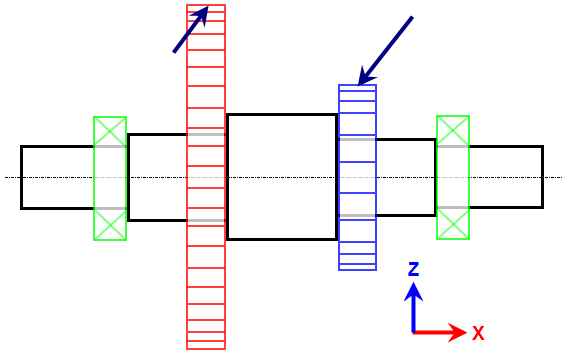

Example – Use of Remote Loads and Remote Constraints
Figures 1 and 2 illustrates how to use remote loads to analyze a shaft (made from brick elements) that is part of a gear train. In the FEA Model, the two boundary conditions at the bearings prevent the shaft from rigid body translations in all directions. The bearing on the left is held radially (Ty and Tz) and axially (Tx, to contain thrust loads), and the mounting of the bearing on the right constrains radial translation (Ty and Tz) but allows axial movement (floating bearing). Assume the bearings are spherical, so that they do not restrain rotation in any direction.
If the load at the pinion were to be modeled with a force, the shaft would still be free to rotate about the axial direction. This would lead to an unstable model and potentially wrong results. A remote boundary condition at the pinion tooth that restrains the model in the tangential direction prevents axial rotation (Rx) and produces the reaction force needed to balance the gear load.
Figure 1: Diagram of Shaft With Gears
| 1 - Remote Constraint attached to surface of bearing journal with a no-translation constraint at center of bearing (Tx, Ty, and Tz).  2 - Remote Load attached to gear mounting surface with force applied at gear tooth location.  3 - Remote Constraint attached to pinion mounting surface with boundary condition in tangential direction (Ty).  4 - Remote Constraint attached to surface of bearing journal with axial and radial constraint boundary conditions (Ty and Tz).  |
Figure 2: Equivalent FEA Model Using Remote Loads
