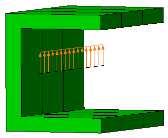

When beam, plate/shell, or 2D elements are included in the analysis, the parts can be displayed or rendered as the 3D geometry instead of the line or planar geometry. This can be done by right-clicking on the heading for that part in the browser and selecting the 3D Visualization command. Table 2 and Figure 1 provide additional details. In all cases, only the nodes and elements on the original mesh can be selected; the fictitious nodes and elements created to show the 3D shape cannot be selected. Loads and boundary conditions are shown at the original mesh.

| Beam | Linear and Nonlinear | Cross section shown with 3-D visualization. Beam elements can only be visualized if the cross-sectional properties were defined using the AISC 2001 or 2005 cross-section library or using one of the pre-defined User Defined shapes (wide flange beam, channel, and so on). |

|  (a) Beam element with loads. A beam element mesh is simply a straight line; the cross sectional properties are treated analytically. |  (b) With 3D Visualization active, the actual cross sectional shape is shown. Note how the loads are still shown on the original elements. |
