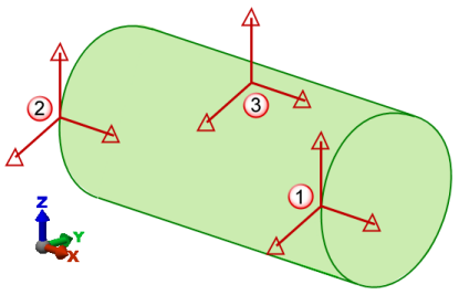

In cases where parts are free to move until they interact with other parts, these free parts must be restrained with weak springs. The goal is to provide stability to all parts, but allow them to move a considerable distance in the process. If contact is not considered on some iteration, the weak springs restrain the part so that the processor can calculate a solution, but then the processor detects that some contact has occurred, and then proceeds with the next iteration and includes contact. Since the weak springs do not exist in reality, the stiffness needs to be set to have minimum affect on the results. The load that is transferred from the model to the ground through the springs should be a small portion of the applied loads. See Figure 1.

Figure 1: Three Sets of Springs on a Pin Provide Stability
Consider a pin held with contact in a clevis. (The clevis is not shown for clarity.) The springs at 1 and 2 prevent the pin from translating in X, Y and Z, and rotating about Y and Z, but do not prevent the pin from rotating about the X axis (technically, the line joining the nodes at 1 and 2). The springs at 3 prevent the pin from rotating about this. (Technically, the springs in the X and Y direction at point 3 are not necessary but can be included for convenience.)
