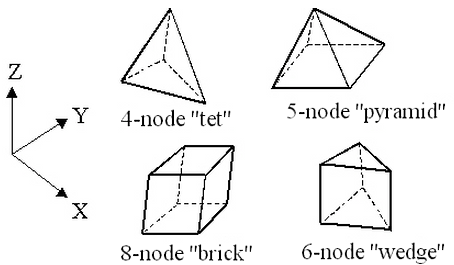

Three-dimensional thermal brick elements are 4-, 5-, 6- and 8-node elements formulated in 3D space. The determination of how many nodes comprise a given element is done automatically based on the connectivity of the lines. You do not need to do anything to designate how many nodes will be on the element. A model made of 3D bricks can contain a mix of 4-, 5-, 6- and 8- node bricks.
Figure 1: Brick Elements
