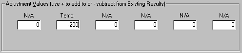

  5. Specify -200 (negative 200) for the Temperature Adjustment Value. This will reduce all calculated temperatures by 200 degrees. (For a heat transfer analysis, only the second degree of freedom, the temperature, is used.)

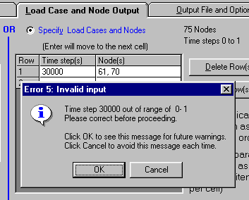

  3. On the Load Case and Node Output tab, choose Specify Load Cases and Nodes. In Row 1, enter a Time Step of 30000. You will get a warning message that this time step is beyond the range of the current results 0-1. Click OK. When the New Results file is created, this invalid time step will automatically be adjusted to the last time step in the analysis, as shown in the error log file.

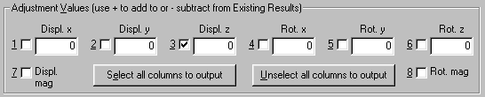

  6. Since only the Z displacement is required, turn off all the check marks except for the Displ. z in the Adjustment Values section.

When TranDO_i is executed from your application, there should be only one warning error in the error log file (TranDO2.log). It is the same error that occurred when you were setting up the Recall Input file.
Nodal Results Translator 16.000
'documentation example.lcn' read at 01-05-2003 12:00:23
Error # 5: Time step 30000 out of range of 0- 1
Number of fatal errors..: 0
Number of warning errors: 1
Since this is just a warning (known ahead of time) and not an error, the output file is created properly. Your application can proceed with its work.

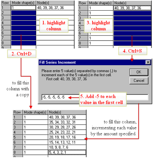

Reverse the Results. Imagine that for whatever reason, you want to have the results for a 40 node model output in reverse order, from the last node to the first node. The Load case spreadsheet is the obvious way to accomplish this. Unfortunately, the nodes cannot be specified as 40-1; the Nodal Results Translator automatically reverses the node order to be in ascending order (nodes 1-40) when the Create File button is clicked. Instead, enter the first row of data, and then use the hot keys to fill in the load case spreadsheet using the 5 steps shown in the figure. To make the grid easier to read (and easier to type), enter the first 5 node numbers on the first row, in reverse order of course.

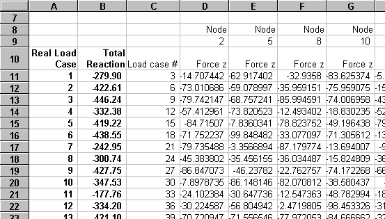

Total Reaction Force. Imagine a static stress analysis with 20 load cases from which you want the total reaction force in the Z direction for each load case. The Nodal Results Translator can output the reaction at each of the supports. Then you can import the results into a spreadsheet and sum them. Here's how.
  1. Start the Nodal Results Translator and select the existing Linear Static Stress reaction forces (*.ro) file.
  2. On the Load Case and Node Output tab, select the load case spreadsheet (Specify Load Cases and Nodes).
  3. Insert rows until 20 rows are in the spreadsheet (for the 20 load cases to output).
  4. For the load case in row 1, enter a value of 3. (Recall from the Appendix Analysis Types and Codes in the DO File that reaction forces are grouped in sets of 3 load cases for linear static stress. Load case 3 is the support reactions for the first case. This is also indicated in the load case list.)
  5. Highlight the load case column and press Ctrl+S (or right-click and choose Fill Series). Enter an increment of 3 on the Fill Series Increment pop-up and click OK. This fills in all the load cases.
  6. Enter the node numbers for the supports in row 1. Highlight the Node(s) column and press Ctrl+D (or right-click and choose Copy Down).
  7. On the Output File and Options tab, indicate to output the results to a text file and specify a Comma Separated Variable (*.csv) file. This will make it easy to import into a spreadsheet.
  8. Check the box for Group results on single row.
  9. Uncheck all the Adjustment Value boxes except for the Force z box.
  10. Create the new results file and open it with your spreadsheet program.
  11. The case number and support reaction at the individual nodes are not of interest in this case. So insert two columns into the spreadsheet. In the first column, add a formula for the real load case which equals the file's load case divided by 3 (formula in cell A11 = C11/3, copied down the 20 rows). In the second column, add a formula that sums the values for all the nodes on the row (formula in cell B11 = sum(D11:J11) if there are 7 nodes with supports).
