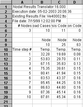

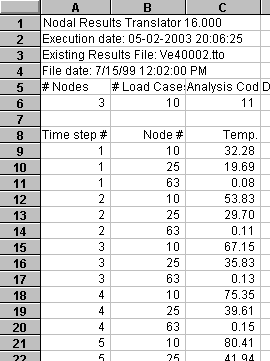

The difference between grouped results and ungrouped results can be seen in the following example.
''Group results'' unchecked. The selected results (temperature from a transient heat transfer analysis in this sample) are written one node per line, placing all results in one column. (The Nodal Results Translator output shown imported into a spreadsheet.) |
''Group results'' checked. The same set of results is written one time step/load case per line, placing all results in multiple columns. This format is easier to plot and do other manipulations, such as the average result over time. |

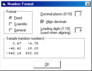

Specify the format of the text output with the Number Format pop-up. A sample, based on randomly generated numbers, is shown as each option is changed. |
