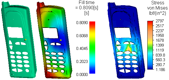

Autodesk Simulation Moldflow provides easy-to-use tools that simulates the injection molding process, which allows the user to optimize the part, mold, and tool designs long before manufacturing begins. By using a digital prototype to simulate the injection molding process, you can reduce the number of physical prototypes required to perfect a design and get your products to market faster.
Because injection molding can result in materials that are anisotropic in nature (different properties in different directions) and with varying orientation of the fibers throughout the part, performing a Moldflow analysis and incorporating the results in the Simulation Mechanical stress analysis will provide a more accurate simulation.

- For parts that correspond to the plastic part(s) to be analyzed in Moldflow, set the Element Definition: Material Model to Moldflow. This is an anisotropic material model.
- Select a material as usual. When the material model is set to Moldflow, the library will automatically show the Autodesk Simulation Plastics Library. A different library cannot be chosen, and a custom material cannot be entered.
Note: The homogeneous isotropic properties from the library are shown. The analysis will get the actual anisotropic properties from Moldflow.

Moldflow Adviser or Moldflow Insight. This will display a Browse For Folder dialog; select a folder where the Moldflow project will be created. Each Moldflow part in the Autodesk Simulation will create a different Moldflow study within the Moldflow project. Optionally, activate the Start Autodesk Moldflow after exporting checkbox if ready to run Moldflow. Note:
- Autodesk Moldflow Insight performs various analyses, including both residual stress and coefficient of thermal expansion (CTE).
- Autodesk Moldflow Adviser performs a subset of the analyses available with Moldflow Insight. Adviser also supports CTE, but does not support residual stress.
The Moldflow project is located in a folder underneath the user-selected folder. The folder and project names default to name of the Autodesk Simulation model. The default name for each study is the Autodesk Simulation part number and part name. Spaces, dashes, and other special characters in the names are changed to underscores (_) in the Moldflow name.

- Review the results, as usual. Note that results related to the Moldflow analysis, including the orientation of the fibers, must be viewed in Moldflow.
