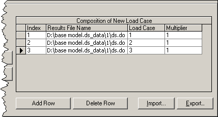

The right half of the Specification of New Load Cases section is used to indicate which previously analyzed models to combine, which load case to use from the models, and the multiplier used for each load case. Use the Add Row and Delete Row buttons to add or delete rows to the spreadsheet to specify additional model results to combine.
Figure 2: Models to Combine(continued from Figure 1)
Clicking in the Results File Name or Load Case cell of the spreadsheet will give a new dialog window. Use the Select Results File button on the new dialog to indicate which results file to use in the combination. Be sure to set the Files of type: drop-down arrow as necessary for the type of results to select. (Also, keep in mind that the results are located in the design scenario folder under the model's ds_data folder.) After the file is chosen, use the Existing load cases in file pull-down on the new dialog window to indicate which load case to use from the analyzed model. Click the OK button to fill the information into the spreadsheet.
Click in the Multiplier column of the spreadsheet to enter the multiplier for the chosen load case. The multiplier can be any value: positive or negative, whole number or fraction.
