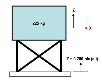

Given: A flexible system with a moving base is composed of a body having a mass of 225 kg, a stiffness of the supporting structure of 35000 N/m, and a damping factor of 0.188. The base oscillates sinusoidally with an amplitude of 0.280 cm at the natural frequency of the system.
The physical assembly.
The base is vibrated at the natural frequency of the structure.
The equivalent representation.
k = 35000 N/m
ζ = 0.188
x and y are typical nomenclature in vibration text books for measuring the absolute motion of the mass and base. The lowercase italic nomenclature x and y indicate the position as a function of time.
Find:
- The amplitude of the mass's displacement relative to the base.
- The absolute amplitude of the mass's displacement (displacement relative to a non-moving source).

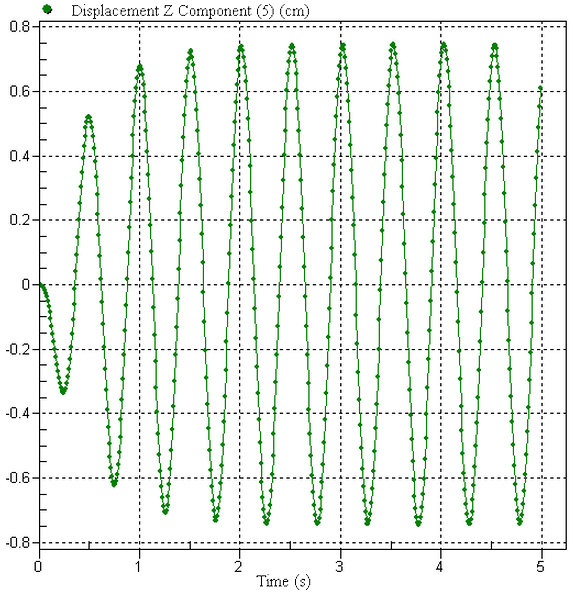

- When the analysis completes, the model is shown in the Results environment. Note that 500 time steps of results are available for review: one for each calculation step. Rather than reviewing the results one time step at a time, it makes sense to plot the results.
- Set the results type to Z displacement (Results Contours
Displacement
Z).
- Select the node at the lumped mass (Selection
Shape
Point or Rectangle and Selection
Select
Nodes and click the node at the top of the model). Right-click and select Graph Value(s). This creates a second presentation window with a graph. The results should look like Figure 2. Quasi-steady state conditions are reached after approximately five cycles. Visually, the results appear to be about 0.75 cm, the expected displacement of the mass relative to the support.
- Return to the contour window, Presentation 1 <Unnamed> by clicking it in the tree view. A time step near 4 seconds should be near the maximum so that we can check the actual value of the displacement. Use Results Contours
Load Case Options
Load Case
Set and enter a value of 400, and click OK. Advance forward or backward a few time steps (Results Contours
Load Case Options
Next or Previous) until the step with the maximum displacement is found. Step 403 has a displacement of 0.742 cm.
Figure 2: Displacement Plot of Mass.
