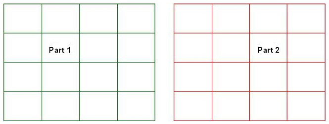

You should change the part number whenever a part of your model is of a different material and/or when you have multiple element types or element properties (such as thickness) in the model. If you have aluminum and steel in the model, you need two parts in the model. Also, if you are modeling a structure with beam elements and plate elements, you need two parts in the model. Finally, each part in the model must consist of complete elements. Therefore, at the interface of different part numbers you need the lines to be defined in both of the parts meeting at that location.

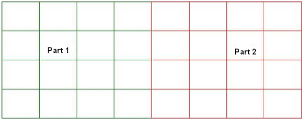

For example, you have elements of Part 1 and Part 2 that meet as shown here:
It appears that the interface only consists of Part 2 lines. However, if we separate the two parts (as shown below), we see that each part has lines at the interface as desired. This is exactly how the interface of different part numbers should be modeled so that we have complete elements for Part 1 and Part 2.
