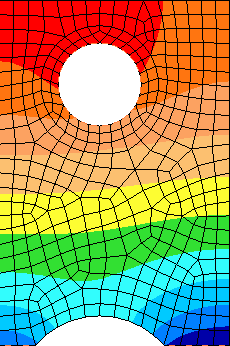

(a) Temperature results from a thermal analysis

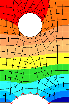

(b) Loaded into a stress analysis with a coarser mesh.

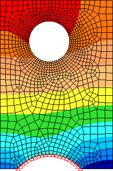

(c) Loaded into a stress analysis with a finer mesh.
Figure 1: Mapping Temperature Results to a Different Stress Mesh

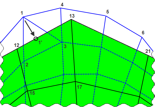

When the type of load supports different meshes in the two models, the model with the results must be a complete model. The results will be transferred between different meshes by mapping the nodes in each part of the result's model to the same part number in the target model. The mapping is as follows:
A highly magnified drawing (and exaggerated for clarity) of two meshes of the same part in two different models. The results are being transferred from the model shown in green and shaded to the mesh of the target model (shown in blue, un-shaded, and behind the mesh of the results model). Node 1 is outside the volume of the results mesh, so it is projected onto the surface of the results (point 1'). Shape functions are used to interpolate the result from element 12-13-17-15 to the nodes 1', 2, and 3. The result at 1' is assigned to node 1.
Figure 2: Example Node Mapping

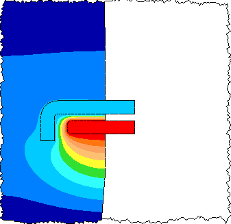

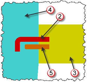

(a) complete model with parts 2 through 5. Part 3 is an insulator, and part 4 is air.
(b) The voltage result from an electrostatic analysis. Part 3 is not included in the analysis.

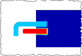

(c) The voltage load in a stress analysis. Part 3 is included; part 4 is not included.
Figure 3: Different Part Numbers in Electrostatic and Stress Model
