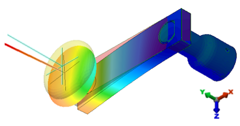

Next, we will look at the displacement results with a transparent view of the undisplaced shape superimposed on the displaced view. Then, we will look at the von Mises stress results.
  1. Select Results Contours Displacement Show Displaced Displaced Options command.
    • Click Transparent. The display appears as shown in the following image.
    • Click Do Not Show to remove the transparent overlay of the undisplaced shape.
    • Close the Displaced Model Options dialog.

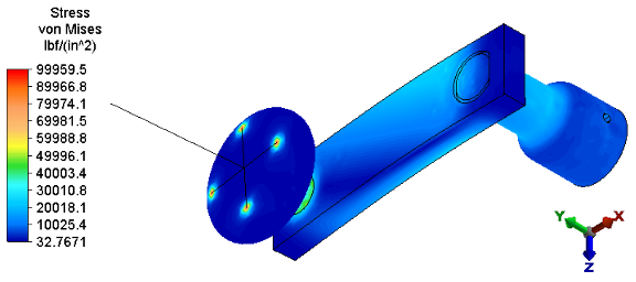

  2. Click Results Contours Stress von Mises. The model displays as shown in the following image. The exaggerated stresses at the beam element attachment points may be ignored.
