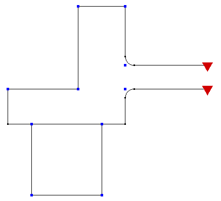

If the mesher detects an error --- such as a break in the sketch outline or overlapping lines on the same part number- it will report that the wireframe does not enclose a single area. It marks the problem area on the model with red triangles. See Figure 1. The red triangles will be removed after correcting the sketch and successfully generating the 2D mesh. (If multiple parts have problems, the mesher will identify the problem in the first part. After fixing it and trying to generate the mesh, the mesher will detect and display the problem in the next part, and so on.) See the introduction for examples of proper and improper sketches for 2D meshing.
Figure 1: Two Part Sketch That Fails the 2D Meshing
The upper part is missing a line segment on the right side.
The red triangles mark the problem areas in the wireframe.
