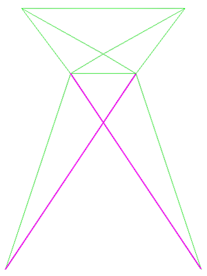

  3. With the Selection Select Lines mode active, press Ctrl-A to select all lines in layer 2.

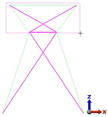

    • With the Selection Shape Point or Rectangle mode active, hold down the Ctrl key, click, and drag to draw a selection box that tightly encloses the short horizontal member and the X-brace above it, as shown below. Be careful not to include any elements from the lower X-brace.
      After releasing the mouse, the upper members are now deselected and only the lower X-brace remains selected, as shown below.

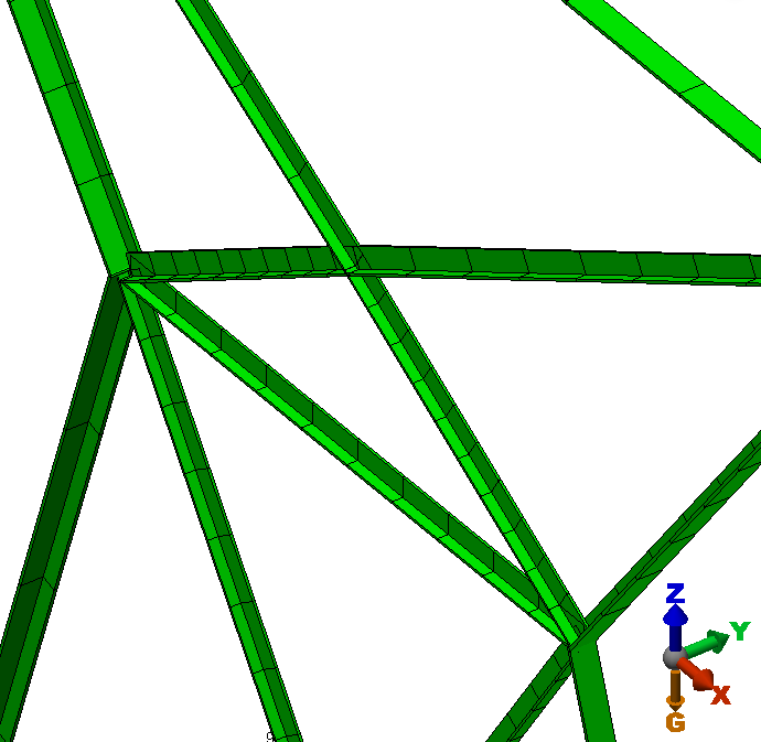

  7. Use the mouse wheel to zoom in (rotate the wheel), to rotate the view (click the middle button and drag the mouse), and/or to pan the view (hold Ctrl while dragging the mouse with the middle button clicked). Carefully examine the orientation of the beams. They should now be consistent, as shown in the image below.
