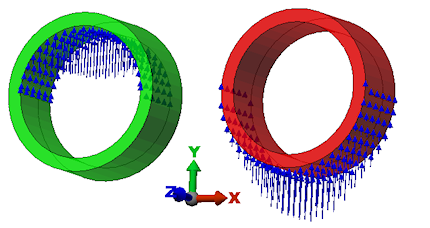

- A bearing load may act against an internal surface (such as the inside of a bearing bore), or against an outside surface (such as the shaft extension where a bearing is to be located). The determination of internal versus external loads occurs automatically for solid elements, as shown in the following image:
 Notice that the vector direction is the same for both parts. The selected surface determines whether the load is internal or external. Both loads are applied in the +Y direction for this example. The left load is applied to the inner surface of the bushing. The right load is applied to the outer surface.

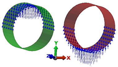

-  For planar elements (plates/shells), you must specify whether the load is to be applied to the inside or outside face. The program cannot infer the intended load from the vector alone. When you apply a bearing load to a planar element, the dialog box will contain an additional input field (Load applied to), which is not visible for other element types. Consider the following plate/shell example:
 Again, the vector direction is the same for both parts (+Y). The left load occurs when the Inside Face option is selected. The right load occurs when the Outside Face option is selected.  Note: The specification of inside or outside face, in the Bearing Load Object dialog box, is independent of the Element Normal Point, which is used to orient planar elements for other types of loads.
