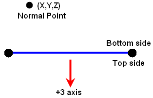

Next, specify an element normal point in the Element Normal section. The X Coordinate, Y Coordinate and Z Coordinate fields in this section will be used to define the element normal point for this part of plate elements. The top of a plate element always points away from the element normal point. This is used for determining which side of a plate element is included in an enclosure with body-to-body radiation. See Figure 2.
| Figure 2: Determining the Element Normal |
| The edge-on view of the plate element is shown. |
