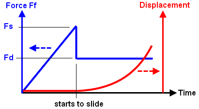

Surface-to-surface contact uses the classical friction algorithm: Coulomb friction. In the basic Coulomb friction model, two contact surfaces can resist shear stress up to a certain amount, determined from friction coefficients and normal contact pressure, before they experience relative sliding motion. The Coulomb friction model is defined as τ = μP, where μ is the friction coefficient and P is the normal contact pressure. Surface-to-surface contact provides the ability for defining a static μ s and dynamic μ d friction coefficients. Ideally, once the shear stress exceeds μ s P obtained from the static friction coefficient, the two surfaces start sliding and the shear stress becomes μ d P where the dynamic friction coefficient is used.
The ideal situation (no motion until the shear stress exceeds the static value) is difficult to achieve numerically, as described in Figure 1. Thus, a Tangential stiffness ratio is defined when using friction. The Tangential stiffness ratio is the ratio of the tangential contact stiffness (K t ) to contact stiffness in the normal direction (K, set under the Advanced button. See the page Surface-to-Surface Contact Advanced Controls.) A larger tangential stiffness results in better accuracy but at the expense of requiring more iterations. A smaller tangential stiffness provides better convergence (shorter runtime) with the possibility of reduced accuracy. The recommend value is in the range of 0.01 to 1. As the static friction coefficient becomes larger, a smaller tangential stiffness ratio is recommended.
 (a) Model and free body diagram of top block. The applied force F is ramped-up over time until it exceeds the static friction force. |
 (b) Plot of friction force Ff versus time (blue curve) and displacement versus time (red curve). Until the friction force Ff reaches the limit of static friction (Fs = μ s xN), there is no motion of the part. Once the static friction is exceeded, the friction force Ff drops from Fs to Fd (= μ d xN), and the part begins to accelerate. |

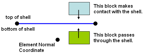

If one of the surfaces in the contact pair is on a part of shell elements, select the side of the shells that will be involved in the contact pair. (The top side is the side opposite of the element normal point defined in the Element Definition dialog.) Contact only occurs when the two bodies approach from the designated direction. For example, it you indicate that contact occurs with the top of the shell, then contact occurs with the second body is moving in the direction from the top toward the bottom. No contact is made if the second body is moving from the bottom toward the top. Another way to visualize this is as follows: the second object makes contact with the chosen side (either the top or bottom) only when it is approaching from outside the shell. It will not detect contact if it passes through the shell to reach the chosen side. See Figure 3.
| Figure 3: Two Blocks Defined to Contact the Top of the Shell |
