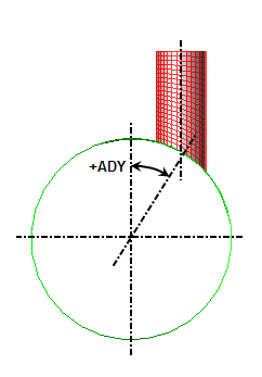

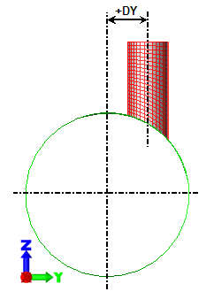

The Offset of nozzle specified using drop-down box on the Intersection tab is used to specify how to specify the offset out of the XZ plane. If the Distance option is selected, specify the location along the Y axis where the nozzle intersects the cylinder in the Nozzle's offset distance (DY) field. If the Angle option is selected in the Offset of nozzle specified using drop-down box, specify the angle at which the nozzle intersects the cylinder in the Angular offset of nozzle's axis (ADY) field. See Figure 1. Note that the nozzle is still parallel to the XZ plane. Note that this value follows the left-hand rule, so a negative angle rotates the nozzle about the +X axis.
Offset of nozzle by distance |
Offset of nozzle by angle |
Figure 1: Offset of Nozzle |

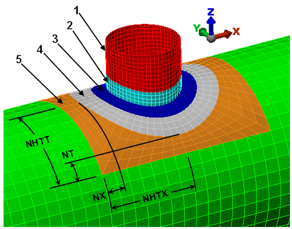

A feature region is a layer of elements surrounding the nozzle and cylinder intersection (see Figure 3). It could be used for additional reinforcement, a region of constant width, or as a region to hide/show the elements and stresses near the intersection. The following steps are used to create a feature region:

You can control the mesh spacing used for each part of the pressure vessel in the Mesh Parameters dialog by accessing the MODEL pull-down menu and selecting the Mesh command. When the Meshing method drop-down is set to Only transition parameters NHTX specified or Only transition parameters NHTT specified, you will only be able to control the mesh size in one direction (NHTX or NHTT) of the transition area where the nozzle meets the cylinder. The rest of the mesh is based on the single input for the transition region mesh size.
To control the mesh in all areas of the model, select the All increments specified option in the Meshing method drop-down box. Go to the appropriate tab for the mesh that you want to specify.
Most of the input is a straight forward number of how many elements are desired along a particular dimension. Those numbers then propagate to other areas of the vessel. For example, NHTT and NHTX determine how many elements are around the perimeter of the nozzle and any head placed on the nozzle. (See Figure 3.) Other parameters on the Mesh Parameters dialog are clarified below.

Key: 1 = nozzle mesh 2 = optional feature region on the nozzle 3 = optional feature region on the cylinder 4 = optional repad on the cylinder 5 = transition region on the cylinder NHTX = half the axial length of the transition region NX = distance between nozzle (or repad or feature region if it exists) and end of transition region in the axial direction NHTT = half the sweep length of the transition region NT = distance between nozzle (or repad or feature region if it exists) and end of transition region in the sweep direction |
| Figure 3: Transition Mesh Between Nozzle and Cylinder |
