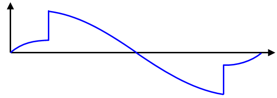

(b) The theoretical rotation or slope of the beams. Note how the result is discontinuous at the hinge points.

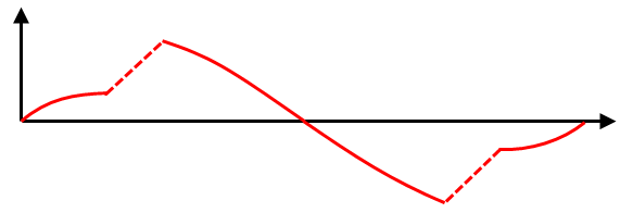

(c) Since there is only one rotation result in the analysis at the hinge points 1 and 2, the rotation results are presented as continuous. The length of the step (shown by dashed lines in the figure) is determined by the size of the element with the end release.
