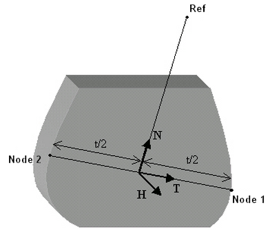

Perpendicular Direction Section: The stress values along the SCL will be reported as six stress tensors. Therefore you need to define the three perpendicular directions that these tensors will be calculated along. These axes are named the T, N, and H axes. The T axis is defined by the SCL.
The figure below shows the local axis configuration if the Define the N Axis option is selected.
