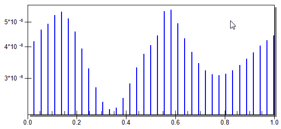

Here is an example of a convergence plot where the X-axis is Time and the Y-axis is Residual. The Plotting Method is Bar, but Point, Line, Spline, and other options are also available:
