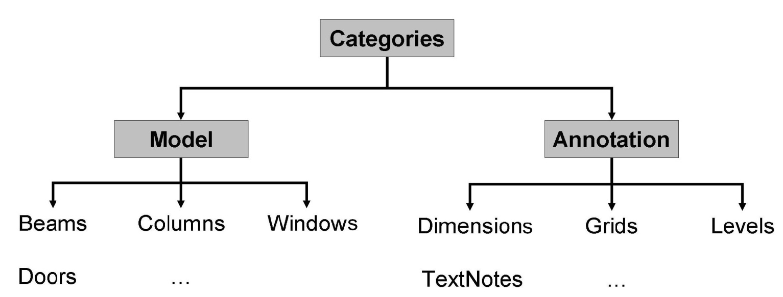

Categories are the most general class. The Document.Settings.Categories property is a map that contains all Category objects in the document and is subdivided into the following:
Figure 20: Categories

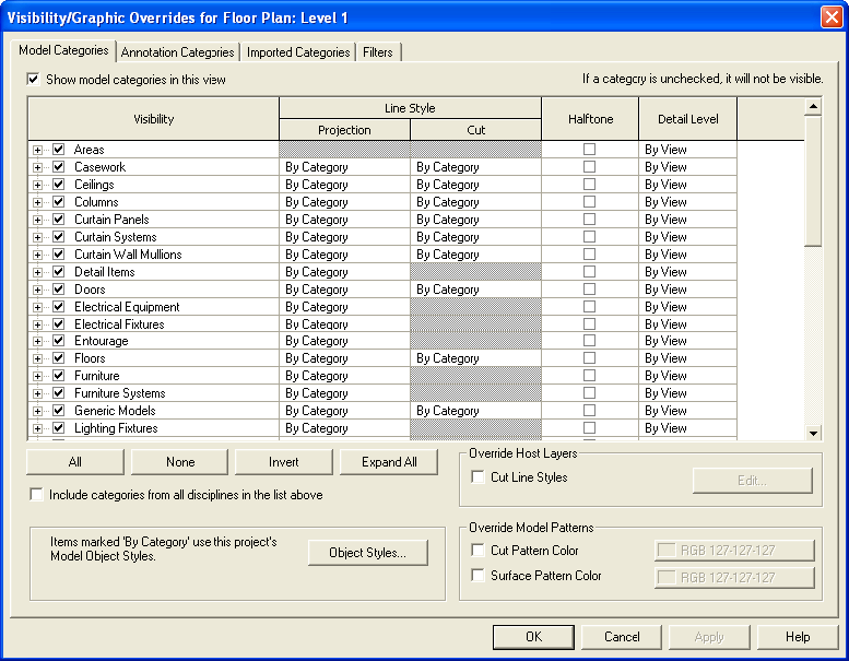

Figure 21: Visibility by Category
An element's category is determined by the Category ID.

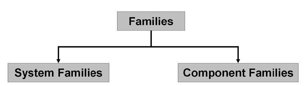

Families are classes of Elements within a category. Families can group Elements by the following:
Most families are component Family files, meaning that you can load them into your project or create them from Family templates. You determine the property set and the Family graphical representation.
Another family type is the system Family. System Families are not available for loading or creating. Revit predefines the system Family properties and graphical representation; they include walls, dimensions, roofs, floors (or slabs), and levels.
Figure 22: Families
