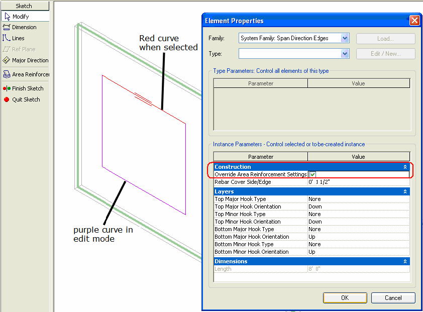

Find the AreaReinforcementCurves for AreaReinforcement by calling the GetCurveElementIds() method which returns an IList of ElementIds that represent AreaReinforcementCurves. In edit mode, AreaReinforcementCurves are the purple curves (red when selected) in the Revit UI. From the Element Properties dialog box you can see AreaReinforcementCurve parameters. Parameters such as Hook Types and Orientation are editable only if the Override Area Reinforcement Setting parameter is true.
Figure 154: AreaReinforcementCurve in edit mode
The Major Direction of the area reinforcement can be set when creating a new AreaReinforcement using the NewAreaReinforcement() method (the last XYZ direction input parameter) and by using the AreaReinforcement.Direction property.
Code Region 29-3: NewAreaReinforcement() |
public AreaReinforcement NewAreaReinforcement(
Element host, CurveArray curves, XYZ direction);
Although the AreaReinforcement.GetCurveElementIds() method returns a set of ElementIds representing AreaReinforcementCurves, which have a property that returns a Curve, the PathReinforcement.GetCurveElementIds() method returns a collection of ElementIds that represent ModelCurves. There is no way to flip the PathReinforcement except by using the NewPathReinforcement() method (the last input parameter).
Code Region 29-4:NewPathReinforcement() |
public PathReinforcement NewPathReinforcement(
Element host, CurveArray curves, bool flip);
Figure 155: PathReinforcement.PathReinforcementCurve in edit mode

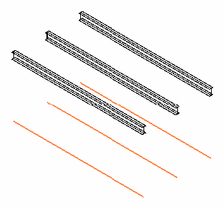

Figure 156: Change BeamSystem elevation

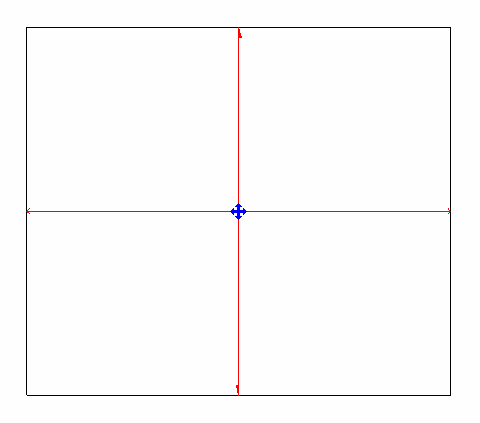

The Slab Span Directions are represented by the IndependentTag class in the API and are available as follows:
Figure 157: Slab span directions
When using NewSlab() to create a Slab, Span Directions are not automatically created. There is also no way to create them directly.

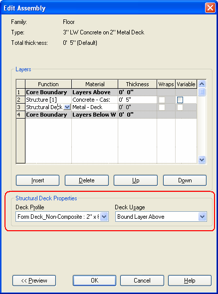

The Slab compound structure layer Structural Deck properties are exposed by the following properties:
The properties are outlined in the following dialog box:
Figure 158: Floor CompoundStructuralLayer properties
