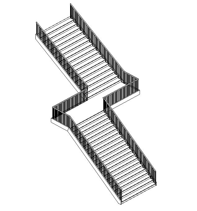

The following example creates a new Stairs object, two runs (one sketched, one straight) and a landing between them.
Code Region: Creating Stairs, Runs and a Landing |
private ElementId CreateStairs(Document document, Level levelBottom, Level levelTop)
StairsEditScope newStairsScope = new StairsEditScope(document, "New Stairs");
ElementId newStairsId = newStairsScope.Start(levelBottom.Id, levelTop.Id);
Transaction stairsTrans = new Transaction(document, "Add Runs and Landings to Stairs");
stairsTrans.Start();
// Create a sketched run for the stairs
IList<Curve> bdryCurves = new List<Curve>();
IList<Curve> riserCurves = new List<Curve>();
IList<Curve> pathCurves = new List<Curve>();
XYZ pnt1 = new XYZ(0, 0, 0);
XYZ pnt2 = new XYZ(15, 0, 0);
XYZ pnt3 = new XYZ(0, 10, 0);
XYZ pnt4 = new XYZ(15, 10, 0);
// boundaries
bdryCurves.Add(Line.get_Bound(pnt1, pnt2));
bdryCurves.Add(Line.get_Bound(pnt3, pnt4));
// riser curves
const int riserNum = 20;
for (int ii = 0; ii <= riserNum; ii++)
XYZ end0 = (pnt1 + pnt2) * ii / (double)riserNum;
XYZ end1 = (pnt3 + pnt4) * ii / (double)riserNum;
XYZ end2 = new XYZ(end1.X, 10, 0);
riserCurves.Add(Line.get_Bound(end0, end2));
//stairs path curves
XYZ pathEnd0 = (pnt1 + pnt3) / 2.0;
XYZ pathEnd1 = (pnt2 + pnt4) / 2.0;
pathCurves.Add(Line.get_Bound(pathEnd0, pathEnd1));
StairsRun newRun1 = StairsRun.CreateSketchedRun(document, newStairsId, levelBottom.Elevation, bdryCurves, riserCurves, pathCurves);
// Add a straight run
Line locationLine = Line.get_Bound(new XYZ(20, -5, newRun1.TopElevation), new XYZ(35, -5, newRun1.TopElevation));
StairsRun newRun2 = StairsRun.CreateStraightRun(document, newStairsId, locationLine, StairsRunJustification.Center);
newRun2.ActualRunWidth = 10;
// Add a landing between the runs
CurveLoop landingLoop = new CurveLoop();
XYZ p1 = new XYZ(15, 10, 0);
XYZ p2 = new XYZ(20, 10, 0);
XYZ p3 = new XYZ(20, -10, 0);
XYZ p4 = new XYZ(15, -10, 0);
Line curve_1 = Line.get_Bound(p1, p2);
Line curve_2 = Line.get_Bound(p2, p3);
Line curve_3 = Line.get_Bound(p3, p4);
Line curve_4 = Line.get_Bound(p4, p1);
landingLoop.Append(curve_1);
landingLoop.Append(curve_2);
landingLoop.Append(curve_3);
landingLoop.Append(curve_4);
StairsLanding newLanding = StairsLanding.CreateSketchedLanding(document, newStairsId, landingLoop, newRun1.TopElevation);
stairsTrans.Commit();
newStairsScope.Commit();
return newStairsId;
The stairs resulting from the above example:
