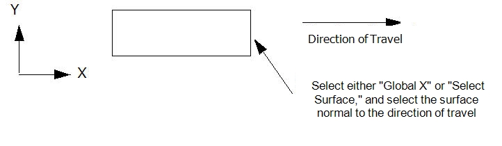

Direction
Either key in a vector or use the pop-out to set the direction of travel of the object.
Choose the Global X, Y, or Z axes to choose a Cartesian direction as the motion direction.
To graphically set the direction, click the Select Surface button, and select a surface. The motion direction will be normal to the selected surface.
Click the Inverse button to switch the direction.
Note: Only planar surfaces may be selected.
An example of assigning linear direction:
The specified direction of travel is the reference direction, and all directional-dependent parameters are relative to it. Specified positive displacements will move the object in the reference direction. Negative displacements will move the object in the opposite direction.
Flow-driven parameters such as driving forces and resistive forces reference this direction as well. Positive values of a driving force will act in the direction of the Direction Vector; negative values will act in the opposite direction. In contrast, positive resistance forces will act in the opposite direction of the Direction Vector; negative resistance forces will act in same direction as the Direction Vector.
