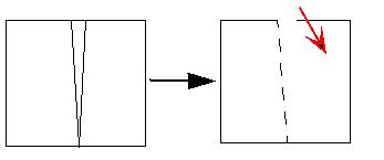

An example of an exaggerated sliver surface is shown, before and after Small Object Removal:
The sliver surface is shown on the left. The result is shown on the right as a tiny gap that will be paved over when the model is meshed.
Note that after Small Object Removal is applied, there may still be visual artifacts of the removed entity. These indicate where the removal occurred, but are largely ignored when the mesh is generated. Some edges (shown dashed above) may represent a constraint for the mesher, depending on the nature of the removed entity.
Entities are considered for removal based on their sizes relative to the minimum refinement length and their comparative size distributions throughout the geometry. The slider range is determined using the same mechanisms as in Edge and Surface mode Model Diagnostics. Objects are considered for removal if they are within a certain range of the minimum refinement length.

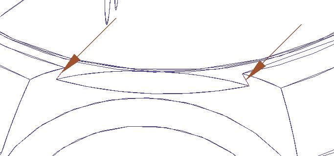

When the tool is first opened, arrows are drawn on the model to indicate candidates for removal:
We recommend that Small Object Removal be invoked before any analysis settings are applied. In the event that settings are present when SOR is run, they will be removed from the model (after a warning is provided).

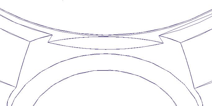

After applying Small Object Removal, the candidate entities are removed, and will not be a part of the simulation model:

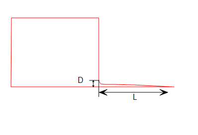

Sometimes well formed surfaces have a sliver "appendage" that can impair meshing of the entire surface:
Small Object Removal removes these slivers if the length to height ratio (L/D) is greater than or equal to 5.
