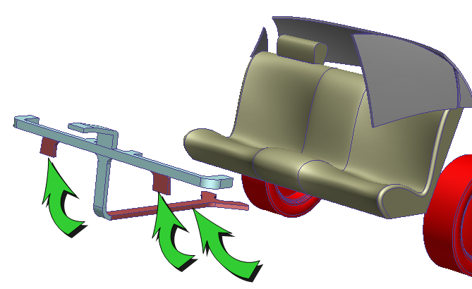

Note: To improve cooling of the floor regions, we will explore a change in the duct design. This requires a change in the CAD model, so we begin by cloning the design.

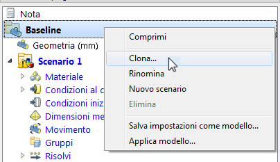

1. Right click on the Baseline design in the Design Study Bar and select Clone…
2. Enter the name “Floor Registers Active” to the cloned design. Click OK.

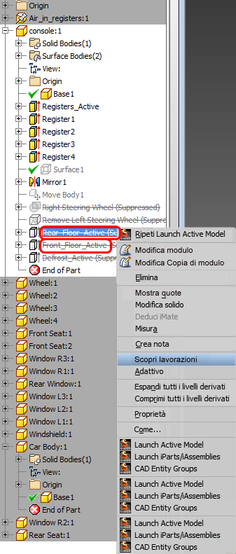

3. In the CAD model, enable the features that allow air to flow to the front floor and the rear floor registers. In the console part (or console-r part for the right-drive configuration), activate the following features:
Rear_Floor_Active
Front_Floor_Active
Autodesk® Inventor

Instead of modifying the model in Autodesk® Fusion, we will change the material definition of the three floor-level ducts to air in Autodesk® Simulation CFD:

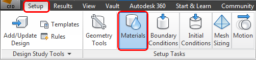

- Click Materials from the Setup tab.
- Hide the Car Body, Cabin Air, and Console parts to reveal the ducts.
- Select the three floor-level ducts:
- Assign Air:
Material DB Name = Default. Type = Fluid, Name = Air. Click Apply.

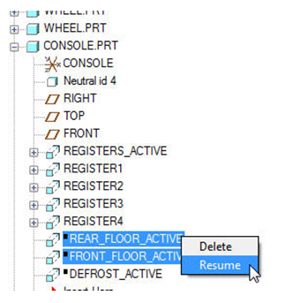

PTC Creo or Pro/Engineer

Note: The objective of this design change is to eliminate the higher floor temperatures. We hope to do this by adding registers to provide cold air to the front and rear floor regions.

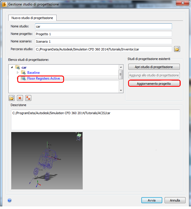

4. Launch Autodesk Simulation CFD and update the cloned design with the new CAD geometry:
To launch from CAD...
- In the Design Study Manager, expand the car design study.
- Select the Floor Registers Active design.
- Click Update Design.

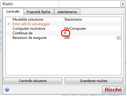

6. Right click off the model and choose Solve…
7. Set Continue From to 0 and click Solve.
8. When prompted if you want to delete all results after iteration 0 and continue, click Yes.
Note: The simulation should take approximately 20 minutes to complete, but your time may vary, depending upon your computer.
