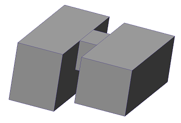

At the start of this example, the reservoir on the left is full, and the one on the right is empty. The reservoirs are separated by a retaining wall with a gate cut-out to allow water to pass between the reservoirs.
Geometry: The two reservoirs and the pass-through gate were created as separate parts in the CAD system.

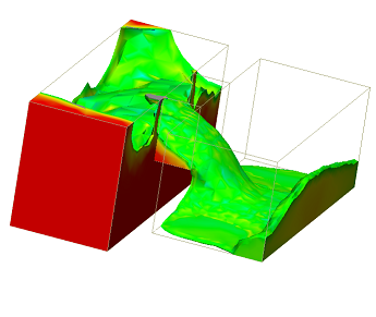

Results:
- To view the shape of the flow, right click off the model, and click Free Surface.
- To animate the filling process, right click off the model, and Animation. On the Animation dialog, click Animate, and the Play button. (If you do not specify a value for results Save Intervals, you will only be able to see the last time step in the simulation.
As you can see, the water flows from the left reservoir into the right reservoir until the water level in the two is the same.
