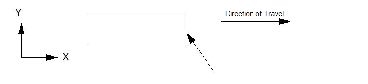

Either key in a vector or use the pop-out to set the direction of travel of the object.
An example of assigning linear direction:
Select either a Global direction or the Select Surface button, and select the surface normal to the direction of travel.
The specified direction of travel is the reference direction, and all directional-dependent parameters are relative to it. Specified positive displacements will move the object in the reference direction. Negative displacements will move the object in the opposite direction.

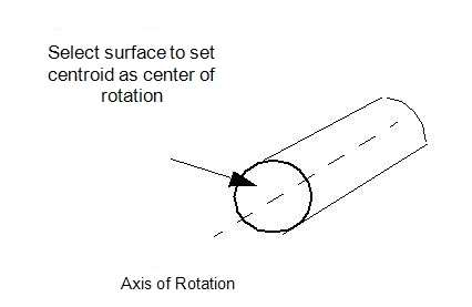

Center of Rotation
The center of rotation is the point through which the axis of rotation passes. There are two ways to specify it: as the centroid of a selected surface or by keying-in coordinates.
To specify the centroid of a surface, open the pop-out, click the Select Surface button, and select the surface.
The axis of rotation will pass through the centroid of the selected surface:
