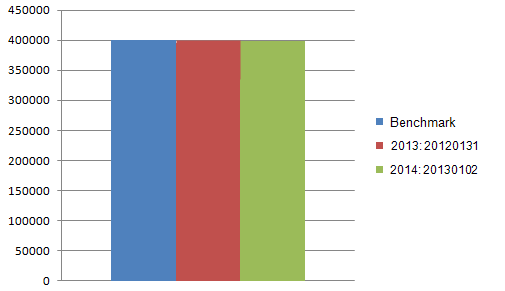

Results
Analytical and numerical calculations of pressure drop are compared. The analytical expression for pressure drop from White (1986) is:
The Darcy friction factor is computed from the Blasius expression:
Using these parameters:
in the expressions above, the following results are computed:
Benchmark | 2013: Build 20120131 | % Error | 2014: Build 20130102 | % Error | |
4.0e5 Pa | 397495.70 Pa | 0.550 | 397744.82 Pa | 0.488 |
