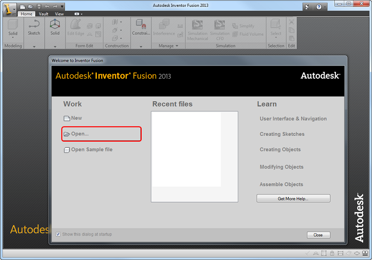

1. Start Fusion, and click Open.

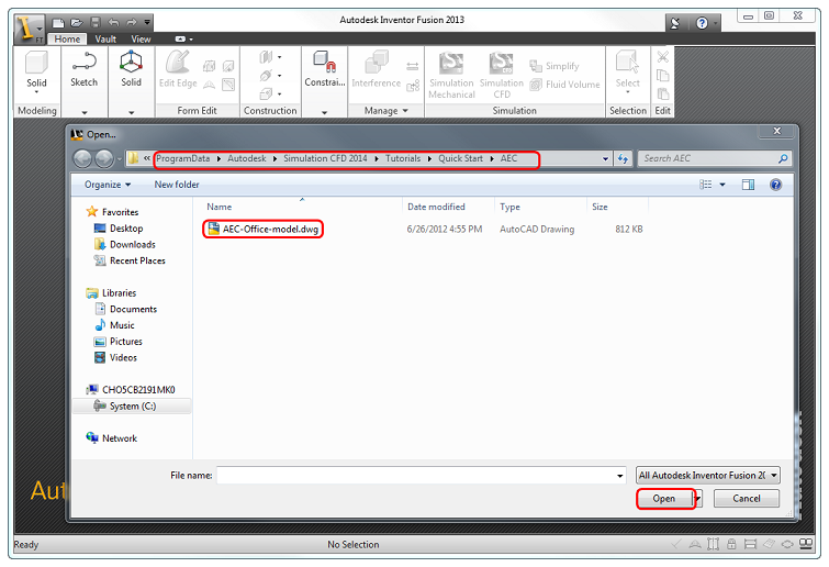

2. Navigate to C:\ProgramData\Autodesk\Simulation CFD 2014\Tutorials\Quick Start\AEC.
3. Select AEC-Office-model.dwg, and click Open.

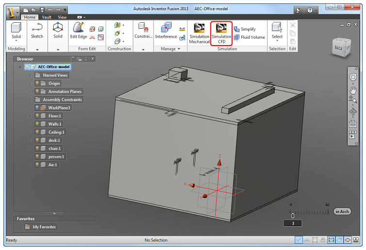

4. To launch into Simulation CFD, click Home (tab) > Simulation (panel) > Simulation CFD:

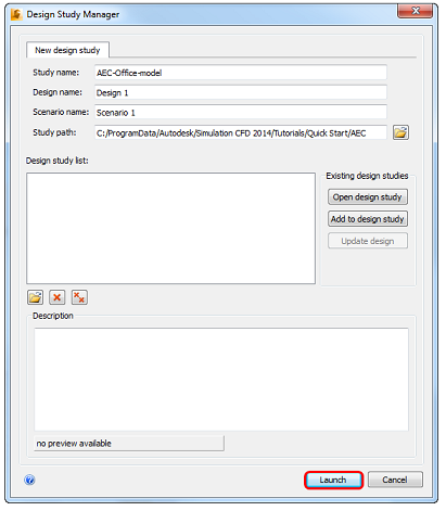

5. On the Design Study Manager dialog, click Launch to complete the transfer into Simulation CFD:

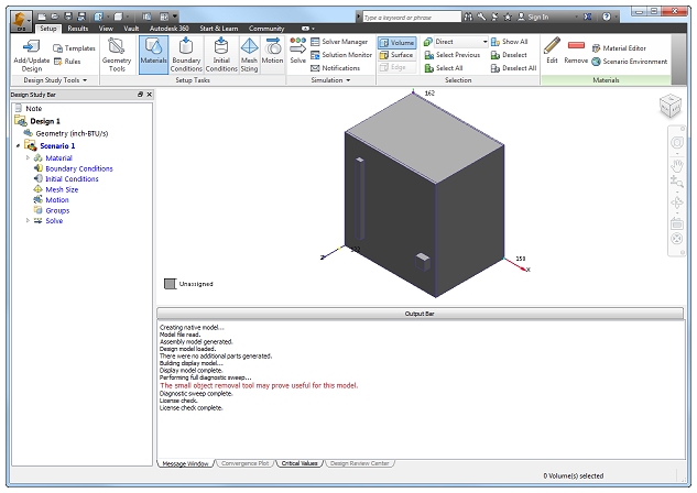

6. You will probably see a dialog called "Geometry Tools." Close it by clicking the "X" in the top right corner:
What it should look like:
Autodesk® Simulation CFD starts, and you should see the model:
