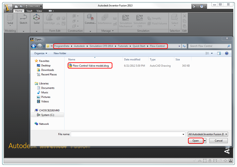

1. Start Fusion, and click Open.
2. Navigate to C:\ProgramData\Autodesk\Simulation CFD 2014\Tutorials\Quick Start\Flow Control.
3. Select Flow-Control-Valve-model.dwg, and click Open.
4. To launch into Simulation CFD, click Home (tab) > Simulation (panel) > Simulation CFD:

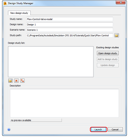

5. On the Design Study Manager dialog, click Launch to complete the transfer into Simulation CFD:

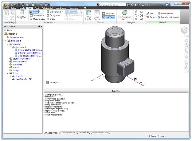

What it should look like:
Autodesk® Simulation CFD should start, and you should see the model:
