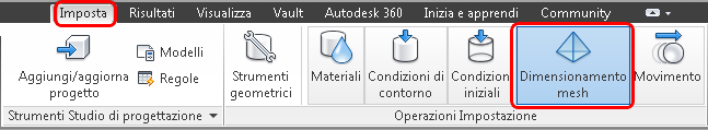

1. Click Mesh Sizing on the Setup tab:

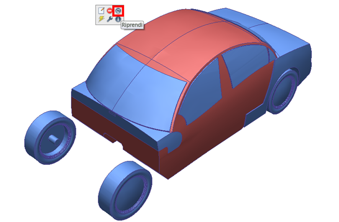

Note: Because we are only studying the air in the cabin, we can suppress all other parts from the model. We begin by suppressing all parts, then resume the air in the cabin for meshing:
3. Right click off the model, and click Select All.
4. Left click off the model, and click the Suppress icon on the context toolbar.
Note: Suppressed parts are colored blue.

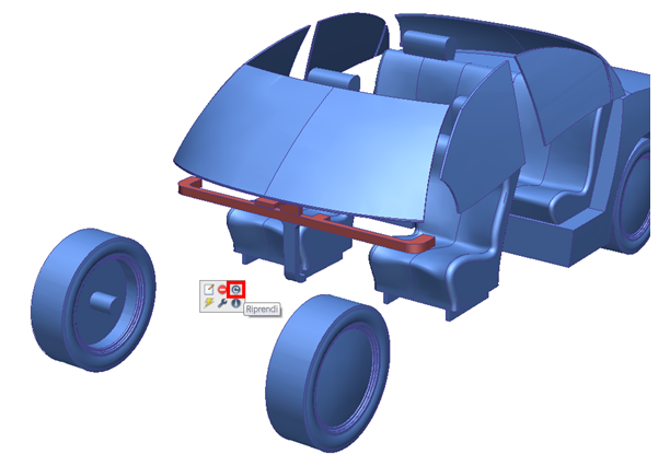

5. Hide the car body. Select the cabin air volume and click Resume from the context toolbar.
Note: Resumed parts are colored gray again.

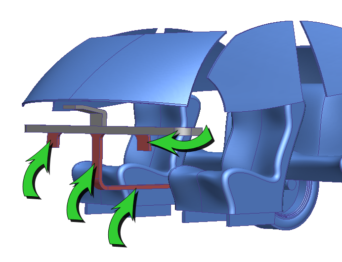

6. Hide the cabin air volume and the console to reveal the ductwork air parts. Select the upper air part and the duct flow region and choose the Resume icon from the context toolbar.
7. Perform this step only if you are using the Autodesk Fusion version of the training model.
Select the four floor ducts, and click Resume from the context toolbar.
Note: For the first design iteration, a solid material is assigned to three of these ducts. This step allows them to be meshed, but no air will flow through them. In the second design iteration, we will change the material to Air, which will allow air to flow through the floor ducts.

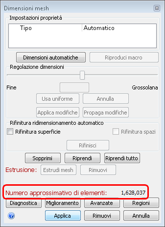

9. To determine if the mesh needs to be modified, check the Approximate Element Count. Right click off the model, and click Edit... Note the element count.
Note: The number you see may be slightly different, depending on slight variations in the model due to the originating CAD system.
Note: Recall that approximately 2 GB of RAM are required for every million elements.

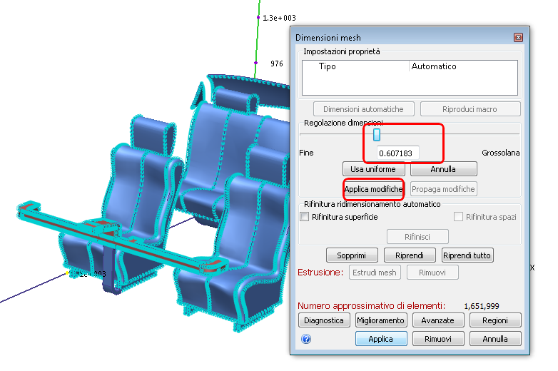

10. Observe the mesh distribution in the model. Notice that the mesh is too coarse in the duct and too fine on the seats.
Note: The mesh preview shows one node across the thickness of the duct. Better results are achieved with 3 to 4 nodes across important passages so we will refine the mesh here. By contrast, the seats contain a finer mesh distribution. Because the mesh distribution on the interior surfaces do not heavily influence the mesh in the flow regions, coarsening the mesh here will reduce analysis resources and time.
11. Select the two volumes of air in the ducts. In the Mesh Sizes dialog, drag the Size adjustment slider to approximately 0.6. Click Apply changes.

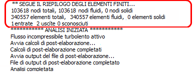

Note: When the mesh is complete, the model color will change to blue, and the last line of the Message Window will be “Analysis completed successfully.”

17. Scroll up in the Output Bar to note the final Element Count.
