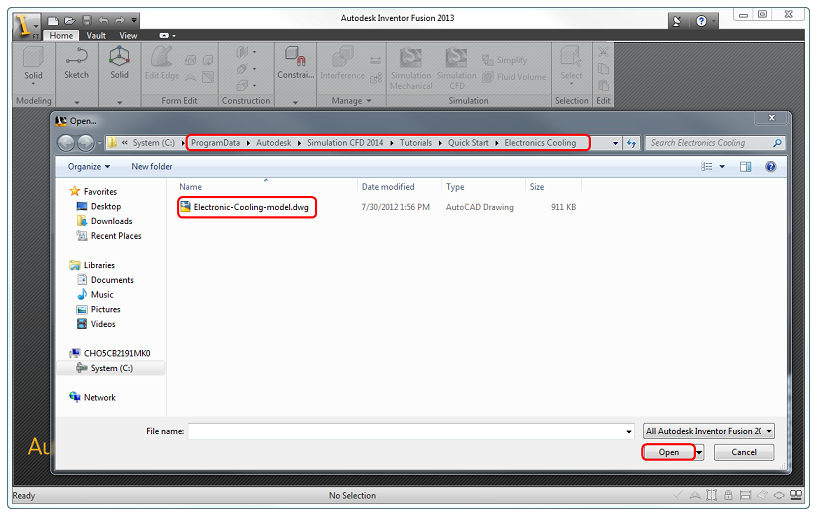

1. Start Fusion, and click Open.
2. Navigate to C:\ProgramData\Autodesk\Simulation CFD 2014\Tutorials\Quick Start\Electronics Cooling.
3. Select Electronic-Cooling-model.dwg, and click Open.

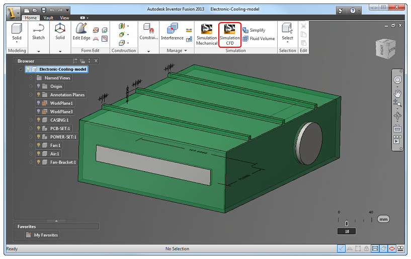

4. To launch into Simulation CFD, click Home (tab) > Simulation (panel) > Simulation CFD:

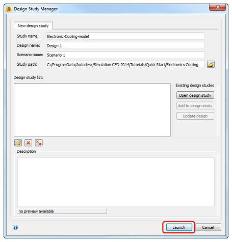

5. On the Design Study Manager dialog, click Launch to complete the transfer into Simulation CFD:

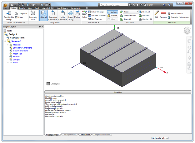

What it should look like:
Autodesk Simulation CFD starts, and you should see the model:
Note: In the next step we rotate the model to see the other side of the enclosure.
