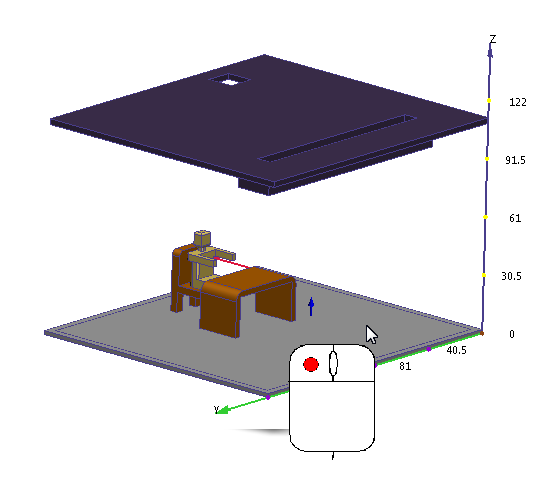

1. Select the floor by left clicking on it:

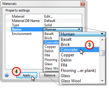

2. Click Edit from the Materials context panel:
3. On the Materials quick edit dialog, verify the Type is Solid, and the Name is Concrete.
4. Click Apply.

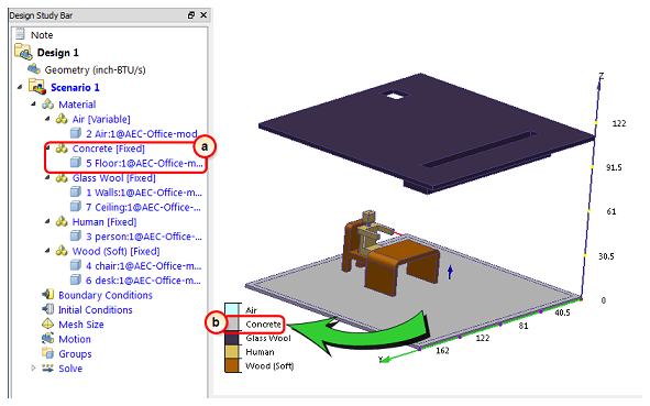

5. To verify that the Concrete material is properly assigned, check the Design Study Bar and the part coloring:
  1. On the Design Study bar, confirm the material assignment for the Concrete part.
  2. The floor part should be colored to correspond to the Concrete color in the legend.
