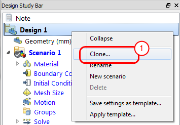

  1. In Autodesk Simulation CFD, on the Design Study bar, right click on a Design, and click Clone. Assign a unique name to the new Design. Note that all scenarios of the Design are also cloned.

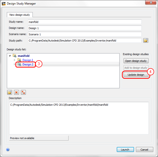

  1. On the Design Study Manager, select the new Design from the list.
  2. Click Update design.
