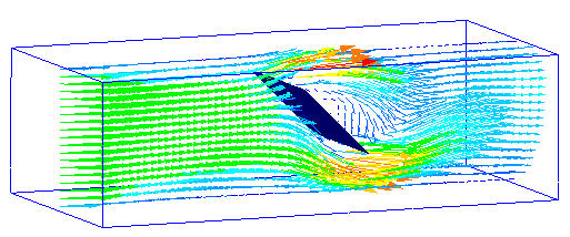

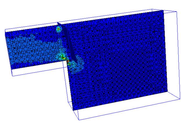

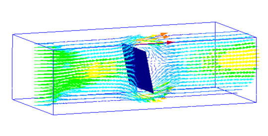

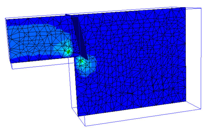

In the image on the left, the 3D mesh surrounding the moving shell is quite coarse. As the valve opens due to the force of the fluid, very little fluid can pass around it until it has opened about half way. In reality, fluid would leak past such a valve at the onset of motion, and is shown in the model with a finer mesh on the right:
