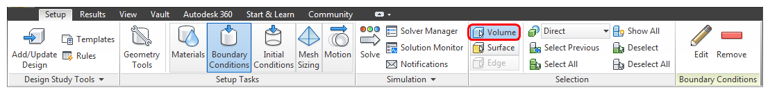

1. To change the selection mode, click Setup (tab) > Selection (panel) > Volume.

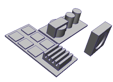

2. Hide the casing and the air parts by pressing Ctrl and middle clicking both. You should see the internal components of the device:

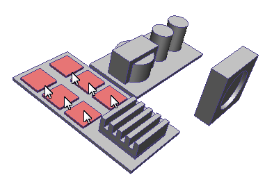

3. Select the six small chips by left clicking them.

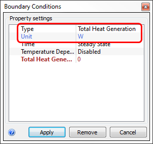

5. Verify that the Type is Total Heat Generation, and the Unit is set to W (Watts).

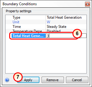

6. On the Total Heat Generation row, enter 3.
7. Click Apply.

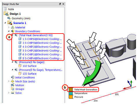

8. To verify that the condition is correctly applied to the chips, check the Design Study bar and the colored stripe on the six chips.
  1.  On the Design Study bar, the Total Heat Generation condition should be listed with a value of 3 W.
  2. There should be a colored stripe on each chip that corresponds to Total Heat Generation on the legend.
