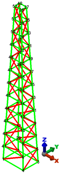

When we set up the frequency response analysis, we must specify the node numbers to which the force will be applied, assuming that we will not be applying the load only as ground motion. We must use the Results environment to find this information.
Results tab above the browser (tree view) to enter the Results environment.
Results Contours
Displacement
Show Displaced
Show Displaced command to show only the undisplaced model.
Appearance
Visual Style
Shaded.
Results Contours
Other Results
None.
Results Options
View
Show Numbers
Node Numbers option. Your model should look similar to the one shown in the following image.
