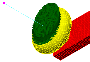

Selection
Shape
Point or Rectangle and
Select
Vertices commands active, click the node at the free end of the beam element that is perpendicular to the top surface of the knob, as shown below.

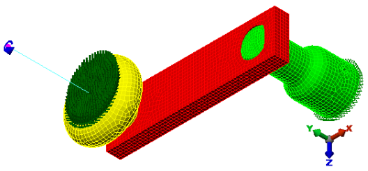

Setup
Loads
Moment. The model should display as shown in the following image.
