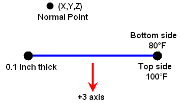

| Delta T thru thickness |
= (Ttop - Tbottom) / thickness = (100 - 80 °F) / (0.1 inch) = 200 °F/ inch |
| Figure 4: Temperature Gradient Through a Plate Element | |
