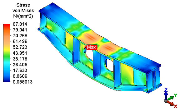

Run Simulation. After solid meshing, the analysis proceeds and the model displays in the Results environment. The maximum non Mises stress is now approximately 88 N/mm2, which is below the allowable stress of 90 N/mm2. The stress results appear as shown in the following image.

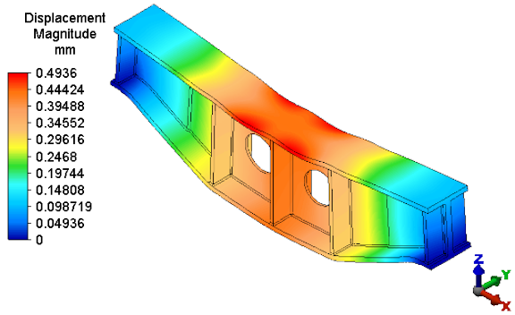

Magnitude. The maximum displacement is now slightly less than the allowable displacement of 0.5 mm, as shown below.
