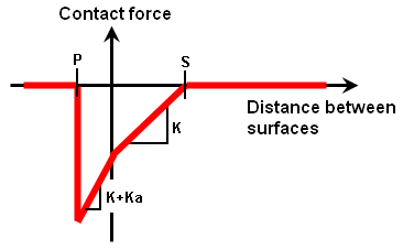

| Figure 1: Contact Stiffness and Contact Distance |
Two surfaces come into contact when the distance between the surfaces is less than the Contact Distance (S). Closer than this distance, the contact force at each element is proportional to the amount of compression (S – distance) and the Contact Stiffness (K). When the distance decreases to 0, the parts begin to pass through each other (penetration). The contact force is then proportional to the contact stiffness plus the Additional contact stiffness (Ka) and the amount of penetration. When the distance between the surfaces reaches the Maximum Penetration Distance (P), the contact force goes to zero. |
The value for the contact stiffness should typically range from 1 to 10% (for "Unit" mesh size) of the Young's modulus value for the softer of the two materials in contact. For a mesh size that is too large or too small, you might need small increases or reductions in the percentage, respectively. If the assumed stiffness is too low, excessive contact penetration will occur. If the stiffness is too high, contact oscillation and instability is likely.
Another way to estimate the contact stiffness is to view the contact elements as a group of springs between the nodes of the two surfaces. If the contact force is known - even approximately - then the contact stiffness can be calculated from K=(F/n)/Δ, where F is the contact force, n is the number of nodes in contact, and Δ is the amount of compression in the contact elements to resist the force F/n. Keep in mind that the contact elements need to compress some amount to generate a force, so choosing a Δ of 10% of the contact distance (S) is a good starting point. However, this method could prove practical only for simple contact models with regular geometry.
If you select the Use adaptive contact stiffness method after first step check box, the contact stiffness is automatically adjusted throughout the analysis to provide improved accuracy and convergence. The contact stiffness is adjusts based on the status of the contact (penetration, no penetration). This method can provide more accurate and efficient solutions for some cases. For models that involve contact between parts moving quickly relative to each other or parts that have nonlinear material models, deactivating this check box could prove necessary.
If the stiffness is too small, large penetration of nodes into the master surface is inevitable. If the stiffness is too large, the geometric boundary condition over the contact area is exactly fulfilled, but quite often the equilibrium iteration becomes unstable. High values of contact stiffness will lead to ill-conditioning of the global stiffness matrix and result in poor convergence.

By default, the processor will calculate a contact distance from the geometry of the model. The contact distance is the distance between the surfaces at which contact will occur. (See Figure 1.) If two surfaces are closer than this distance, the Contact stiffness will be applied. For a specific value to be used for the contact distance, select the User-specified option from the Contact distance drop-down box and enter the appropriate value in the Contact distance field. To avoid penetration, it is best to set the contact distance to a reasonably large value.
If the contact distance is larger than the initial gap between the surfaces, then an interference is created (Surface to Surface and Point to Surface contact only), and a contact force occurs at the beginning of the analysis which tries to separate the bodies. In this situation, it is typical to see the time step be reduced at the beginning of the analysis until the parts come into their new equilibrium.

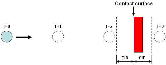

The Contact interaction distance is used to speed the calculations. Contact is only considered if the two surfaces are closer than this value. Thus, if the processor knows the two parts are far apart, there is no need to go through the steps of checking whether they are in contact. You need to be careful that the parts do not move too far from one step to another so that the parts are not in contact at either calculation step, even though the parts actually pass through each other. In this condition, no contact is detected. See figure 4. A value of 0 (which works in some cases but possibly not high speed applications) indicates that the contact distance is equal to the maximum dimension of a surface element on the parts.
Figure 4: Contact Interaction Distance A rapidly moving sphere is shown at four time steps (T=0,1,2,3). Contact is checked only when the bodies are within the contact interaction distance (dimension CID) of each other. In this example, the sphere is outside the contact interaction distance on all time steps, so the fact that it passed through the block is not detected. |

Surface contact is not enforced when a point on the secondary part surface is more than the Maximum penetration distance beneath the primary part surface for this contact pair. (The contact force goes to zero. See Figure 1.) This entry is used to prevent enforcing the fictitious contact between points on the secondary surface which are beneath the primary surface. If this entry has a value of 0.0, then the processor uses the maximum dimension of a surface element as its local maximum penetration distance. We suggest that the user should rarely use any other value beside 0.0 for this entry.
